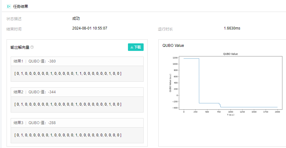

7. Using CPQC for calculations#
Using the Bose quantum cloud platform to call a coherent Ising machine to solve the TSP problem, the results obtained are shown in the following figure. The result has been verified to be the same as the above method, with a time consumption of approximately 1.66ms.
../_images/TSP_cloundplatform_cim_result.png
