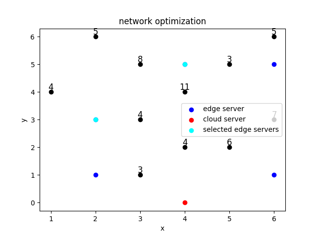

  • A 6×6 grid where each grid has a certain computational demand (only 11 grids have non-zero demand), and all computational demands need to be met.
  • There are 5 candidate locations for edge servers, each with limited computational capacity. When the computational requests received by an edge server exceed its capacity, the excess requests are sent to the cloud server.
  • One location hosts a cloud server, which has no capacity limit.
  • Users can connect to either the edge server or the cloud server (but only one); if the edge server’s capacity is insufficient, it can connect to the cloud server.
  • Minimize cost: fixed cost + variable cost (computational cost) + transmission cost (= unit cost * distance * transmission volume)

import math
# Define CIMSolver class
class CIMSolver:
    # Initialize data
    def prepare_data(self, CAP_EDGE=10):
        # Initialize cloud server costs
        LOC_SET_OUTTER = ['4,0']
        self.C_FIX_CLOUD = {'4,0': 1500}
        self.LOC_SET_OUTTER = LOC_SET_OUTTER
        # Initialize edge server costs
        self.LOC_EDGE = ['6,1', '2,3', '4,5', '6,5']
        self.C_FIX_EDGE = {'6,1': 60, '2,3': 42, '4,5': 46, '6,5': 54}
        # Initialize variable costs
        C_VAR_CLOUD = 1
        C_VAR_EDGE = 2
        self.C_VAR_CLOUD = C_VAR_CLOUD
        self.C_VAR_EDGE = C_VAR_EDGE
        # Initialize user demands
        LOC_SET_INNER_full = ['1,1', '1,2', '1,3', '1,4', '1,5', '1,6', '2,1', '2,2', '2,3', '2,4', '2,5', '2,6', '3,1',
                              '3,2', '3,3', '3,4', '3,5', '4,1', '4,2', '4,3', '4,4', '4,5', '4,6', '5,1', '5,2',
                              '5,3', '5,4', '5,5', '5,6', '6,1', '6,2', '6,3',
                              '6,4', '6,5', '6,6']
        self.DEM = {'1,1': 7, '1,4': 4, '2,6': 5, '3,3': 9, '3,5': 8, '4,4': 11, '5,5': 1, '6,3': 7, '6,6': 5}
        self.LOC_SET_INNER = ['1,1', '1,4', '2,6', '3,3', '3,5', '4,4', '5,5', '6,3', '6,6']
        # Initialize transmission costs
        C_TRAN_ij = 1  # From end to edge
        C_TRAN_ik = 2  # From end to cloud
        C_TRAN_jk = 1  # From edge to cloud
        self.C_TRAN_ij = C_TRAN_ij
        self.C_TRAN_ik = C_TRAN_ik
        self.C_TRAN_jk = C_TRAN_jk
        # All nodes
        LOC_SET = LOC_SET_INNER_full + LOC_SET_OUTTER
        self.LOC_SET = LOC_SET
        self.num_cloud = len(self.LOC_SET_OUTTER)
        self.num_edge = len(self.LOC_EDGE)
        self.num_user = len(self.LOC_SET_INNER)
        # Compute distances
        DIST = {}
        for i in LOC_SET:
            for j in LOC_SET:
                DIST[(i, j)] = round(np.sqrt((int(i.split(',')[0]) - int(j.split(',')[0])) ** 2 + (
                        int(i.split(',')[1]) - int(j.split(',')[1])) ** 2), 2)
        self.DIST = DIST
        # Edge computing node coverage radius
        RANGE = 3
        self.RANGE = RANGE
        # Compute coverage relationships
        ALPHA = {}
        for i in LOC_SET:
            for j in LOC_SET:
                if DIST[(i, j)] <= RANGE:
                    ALPHA[(i, j)] = 1
                else:
                    ALPHA[(i, j)] = 0
        self.ALPHA = ALPHA
        self.CAP_EDGE = CAP_EDGE

    solver.prepare_model()
    # Use simulated annealing to find the optimal solution
    max_iter = 100
    solver.sa(max_iter)
