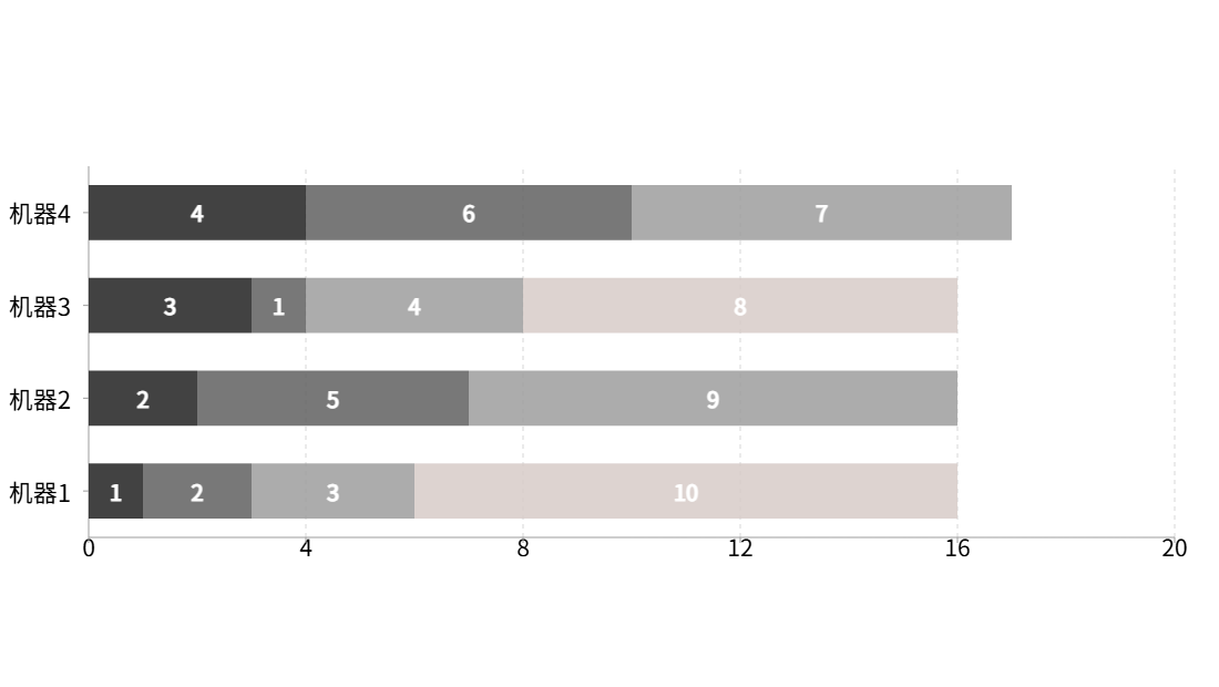

The following diagram shows an example of 4 machines handling 10 tasks. The vertical axis represents machines, and the horizontal axis represents time. The idle start times for each machine are 1, 2, 3, and 4. Each block with a number represents the duration of a task assigned to a machine. The allocation scheme shown minimizes the overall completion time and also provides an optimal solution for load balancing, ensuring that the completion times of all machines are as close as possible.

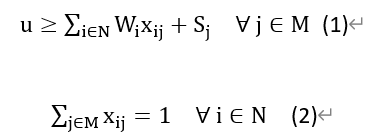

For the first objective, which is to minimize overall completion time, the combinatorial optimization model is established as follows:
Define the variable as the overall latest completion time, which is the maximum of the completion times across all machines.
../../_images/jsp5.png
Objective Function
../../_images/jsp6.png
Constraints
../../_images/jsp7.png
Constraint (1) states that the latest completion time ( u ) must be no less than the completion time ( t_j ) of any machine. Since the objective function is to minimize the latest completion time ( u ), the variable ( u ) will take the smallest value that satisfies (1), which is the completion time of the machine with the latest completion. Constraint (2) ensures that each task is executed by only one machine.

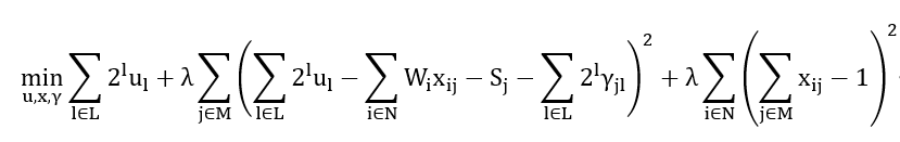

To adapt for quantum computing, the above combinatorial optimization model needs to be converted into the QUBO (Quadratic Unconstrained Binary Optimization) form. QUBO is characterized by decision variables being binary, the objective function being quadratic, and no constraints. Since it involves integers, it can be represented using binary based on multiple binary variables:
../../_images/jsp8.png
Here, ( X_{ij} ) represents a binary variable, which takes a value of 0 or 1. The set of binary digits required depends on the value of the data. Solving for the minimum value thus translates into solving for the binary values.
The next step is to convert the inequality constraint (1) into an equality constraint by adding slack variables. All slack variables are non-negative. Constraint (1) can be expressed as:
../../_images/jsp9.png
Since slack variables are integers, they are converted into binary. Constraint (1) can further be expressed as:
../../_images/jsp10.png

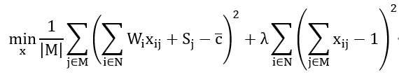

🕐Model 2: Minimize the Completion Time Difference Across Machines (Load Balancing)
For the second objective, which is to minimize the completion time difference across machines, we minimize the variance of the completion times of all machines as the optimization goal, leading to the following combinatorial optimization model:
Objective Function
../../_images/jsp12.png
Note that the average completion time across machines is constant and independent of the allocation scheme, and is defined as \overline{C}.
../../_images/jsp13.png
The approach to QUBOization is consistent with the previous model, so the QUBO model can be expressed as:
../../_images/jsp14.png
